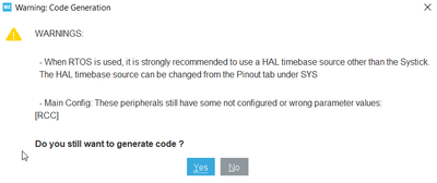

You also generate code under root, it is highly recommended to uncheck "Generate under root".
There also seems to have 2 issues before generating code :
Perhaps you could have a look at the application tick source guide .
Regards,

The clock issue you mentioned is not related to SysTick issue. The one where RTOS recommends the usage of TIM instead of SysTick, is also not related.

Perhaps they are not linked but I think we should fix the obvious issues before fixing the unexpected issues because there is a small chance that they are linked.

Just a couple of considerations :
Regards,
