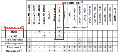

2023-08-25 6:58 AM - edited 2023-08-25 6:59 AM
As stated by TDK there is no mention of DTCM and DMA in the post. I think he tagged F1 product.
Also, your statement is incorrect. In fact, it depends on the product. On F7 family only the CPU could access DTCM, meanwhile on H7 family MDMA could access TCM memories through AHBS bus:
