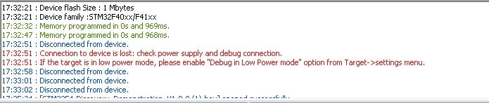

2. When I upload my original program to the board using the ST-LINK utility, it would sort of hang after uploading and automatically disconnect from my computer. I receive the following message
At this point I would not even be able to connect to the board unless I use the ''connect under reset mode'' option in ST-LINK. Flashing the board with default discovery firmware makes this go away.
So what in my original code be causing this?
