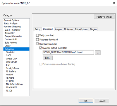

I contacted IAR technical support and got support to enable ECC using IAR Flash loader Macro. Default Flashloader MACRO needs to be modified to enable SRAM ECC. IAR projects settings need to be updated as follows to use updated flash loader file
Default flash loader is available in IAR installation location
C:\Program Files\IAR Systems\Embedded Workbench 9.0\arm\config\flashloader\ST

Hi All,
