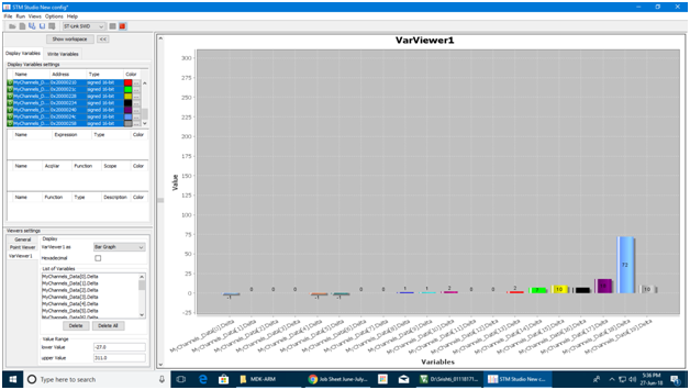

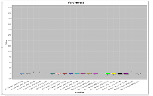

But without overlay there is the touch detection but poor calibration and response below is the screen shot for the same.
When in Ideal State
When a key is pressed without overlay
Kindly advice how to calibrate it by increasing touch sensitivity.

Hi
Verma.V.K
,First, I would like to know if you have already reviewed the application note
: Guidelines to increase the number of touch sensing touchkeys?When using matrix, please note that:
It is recommended to have homogenous sized touchkeys so that each touchkey has the same sensitivity.
This simplifies the threshold setup and acquisition can be achieved using the same sampling capacitor value.In all cases, you have to pay attention to &39ghost effect&39 as described in the application note.
Then, in order to increase touch sensitivity, please take into consideration the following:
I hope this bring you some help.
-Amel
2018-07-05 12:54 AM
I have not made a touch board before, but Ive been working on one last week.
there should be no surface mount parts on the touch side, to reduce air spaces
I think this is your answer:
Reduce air-gap� between pcb and overlay thanks
st.mcu
can you pour some thin goop between the PCB and the 1mm of acrylic ?. and be sure to remove all air bubbles
this will remove all airspaces and increase the sensing range.
It may actually work better with a thicker acrylic/goop.
