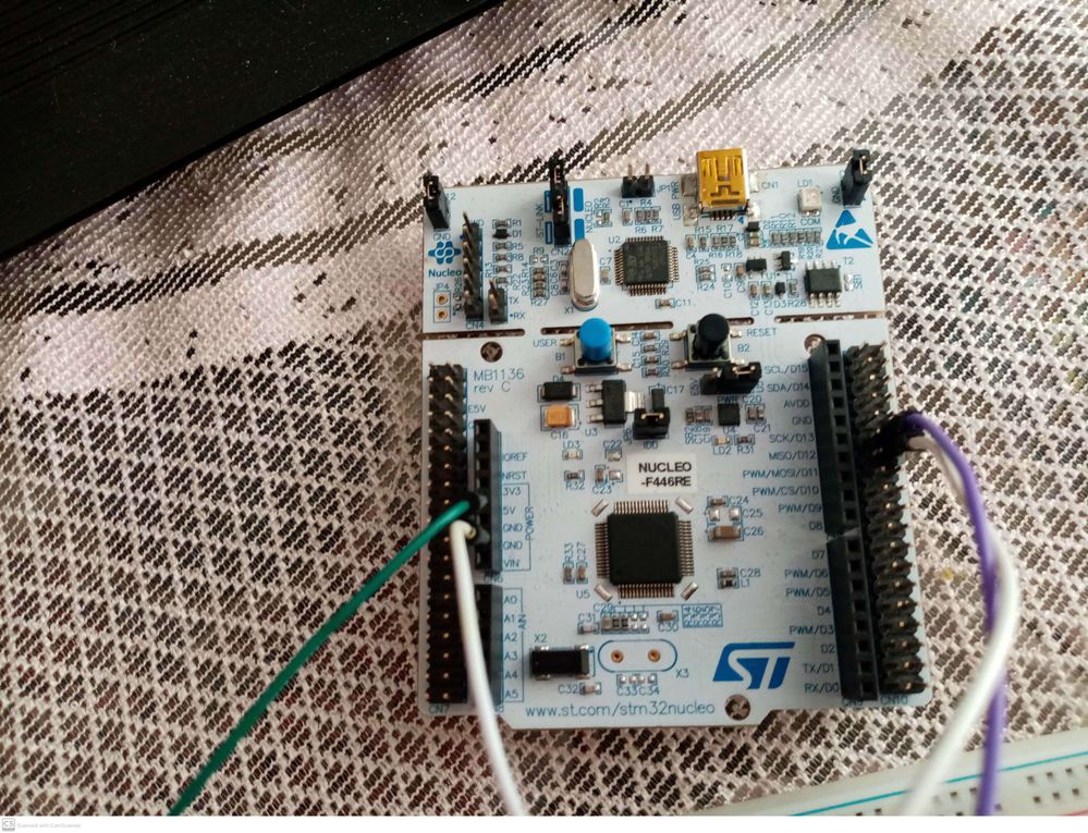

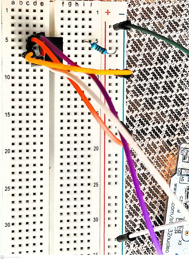

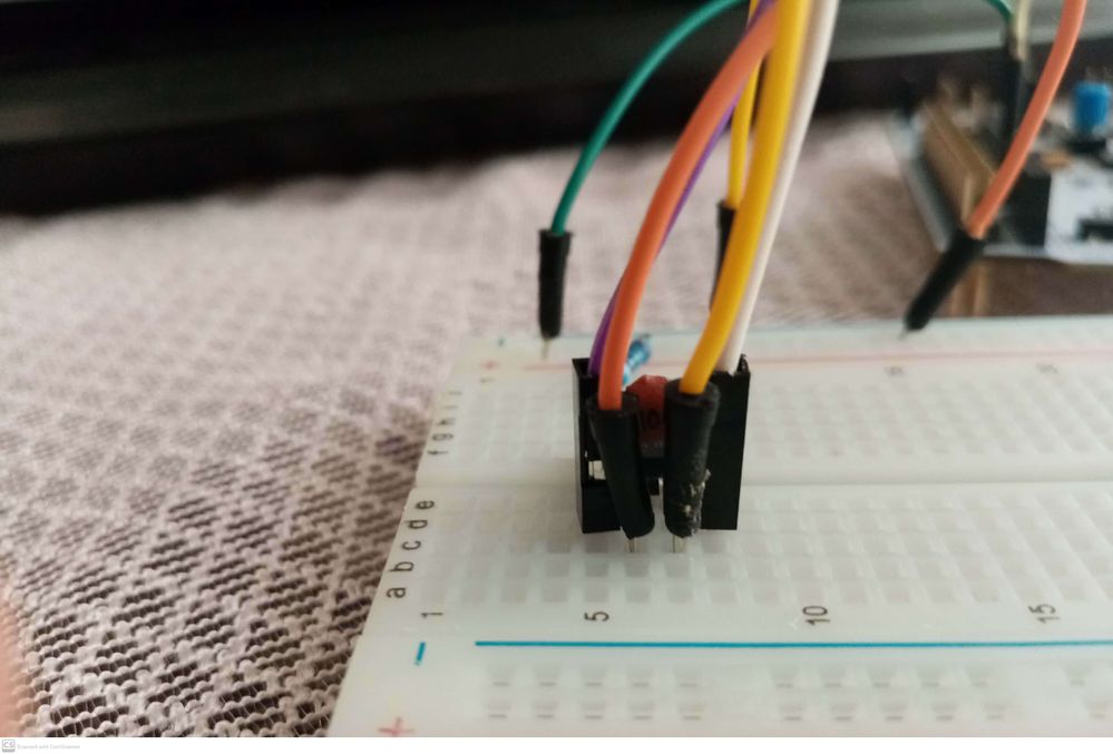

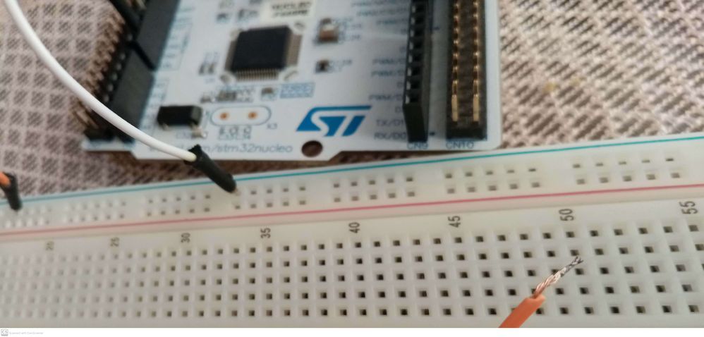

what i expected to see were thousands of CAN messages as soon as i turn on the engine , instead what i got was the "NO MESSAGE" over and over again and since so many things could be wrong i have taken pictures of every hardware part to ask you guys where i must have made a mistake

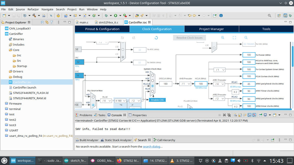

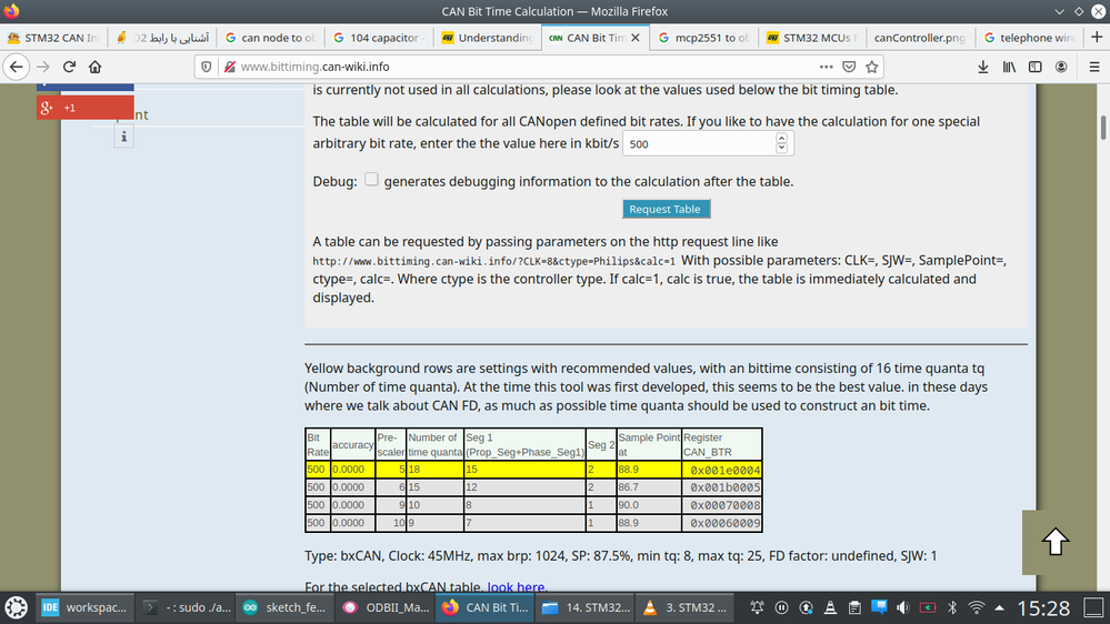

then there is CAN1 init which I set using an online calculator based on the clock tree who's picture i will attach to the end of this post

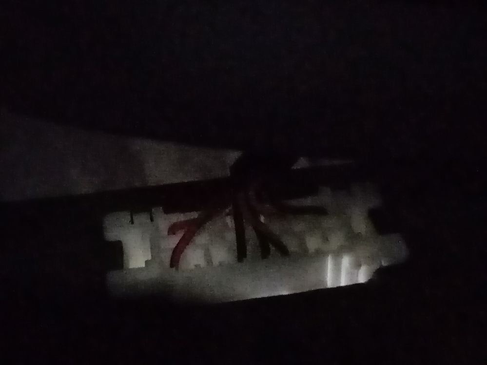

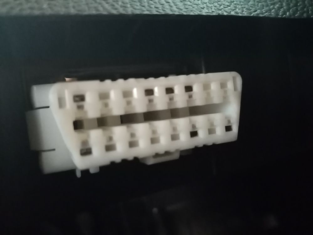

this is the software part , i don't think there is anything wrong with it , the problem is that stm32 LOOPBACK mode is internally connected and even though i can send and receive can messages successfully using loopback i cannot be sure if the mcp2551 ic is working properly. now i will show you pictures of my car's OBD port(i think it supports CAN since it has CANL and CANH wires) also i will attack pictures of the two types of wires i have.not sure which one i should use one is a telephone wire(I haven't used them yet) the other is the ordinary jumper wire type:0693W000008yzJLQAY.jpg0693W000008yzJ1QAI.jpg0693W000008yzIwQAI.png0693W000008yzImQAI.png0693W000008yzHQQAY.jpg0693W000008yzIcQAI.jpg0693W000008yzISQAY.jpg0693W000008yzIDQAY.jpg0693W000008yzI3QAI.jpg:

Do you have the bit/baud rate correct?
Would suggest scoping the signals on the connector and being sure there is a signal present.​
i have read that there are two standard baud rates supported, this clock setting is based on the 500 kbit/sec. i don't know which baud rate is supported by my car's ECU so maybe i should change the init settings after some time. i have a logic analyzer but it only has female connectors i don't know if it supports analog signals , will try to connect it somehow and see.
