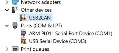

Hi I am new here. I am looking for a driver for Windows 11 Arm (parallels M1).
The chip on my board says STM32F105. The driver that worked for me last time on other Windows was: dpinst_amd64
Can someone advise a driver for Windows 11 Arm (running Parallels Desktop on M1) Thanks

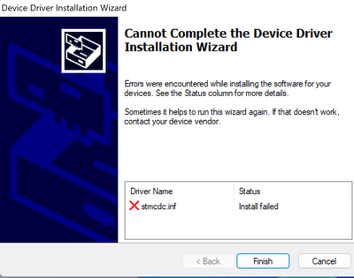

OK, I give up. Unfortunately I am not an IT guru. I need only this to be installed:
Thanks for the information above, but I am really can't understand it

Go fish STMCDC.INF out of your \WINDOWS\INF directory, and figure out how to add a [DeviceList.xyz] node for your ARM installation, perhaps browse other working .INF files?
Should be a Microsoft USBSER.SYS device for ARM. Check what the .INF for the "ARM PL011" looks like. Say use "grep" or some file manager of your choosing.
This ones got suitable nodes for X86 and X64
https://github.com/LORD-MicroStrain/Drivers/blob/master/Windows/Inertial/ST_VCOM/stmcdc.inf

Is it this "starter kit"? https://www.farnell.com/datasheets/2308485.pdf
The "USB serial device (COM3)" can be usbser.sys, not sure what is the "USB2CAN".
Using a normal Intel/AMD PC is the best, simple, cheap way to deal with this device. A custom Windows driver is possible but a Windows laptop may cost you less.
