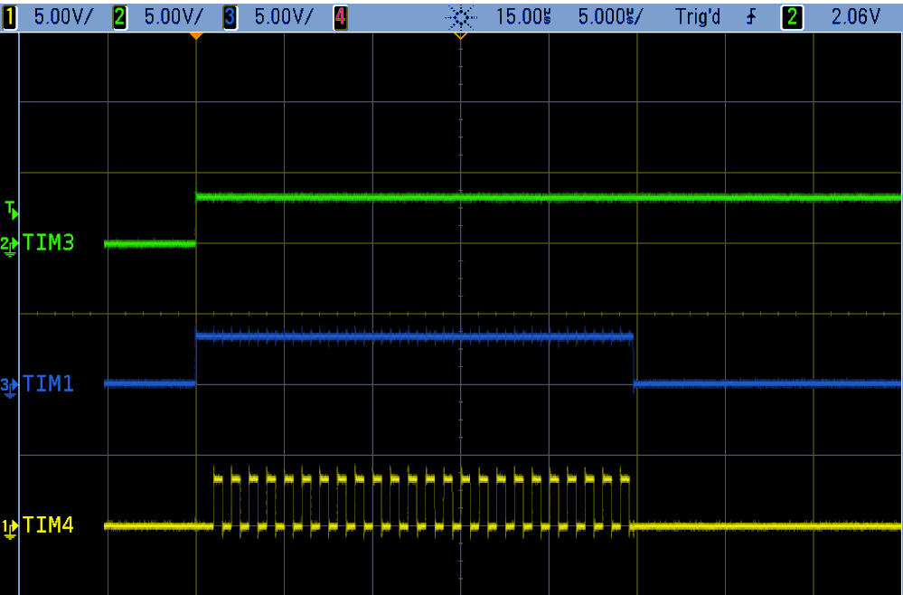

&sharp3. I've tried the following TIM3[Update]---ITR2---->[Trigger] TIM1[OC1REF]---ITR0--->[Gated]TIM4 --->Ch1 PB6. Which is working, but unfortunately TIM1 is tied to APB2 where TIM4 is to ABP1 and therefore the obtained pulses are not correct and they shifting. See the gif.

1. Don't use TIM2 and TIM4 in OCFastMode. So the setup has to be TIM_OCFAST_DISABLE, otherwise strange things like you see in the GIF will appear.
