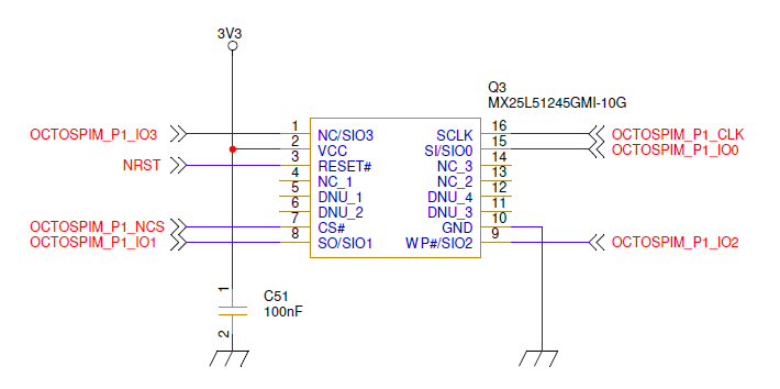

Here's my hardware schematic :

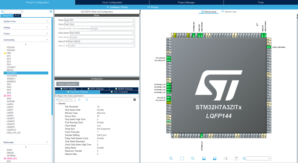

And the MCU pinout/config with the OSPI :

1) On my project with CubeMX, I set the octo-SPI to QSPI mode, with the same parameters used on a random STM32F769I-DISCO TouchGFX template example, except that I have dedicate RESET pin and my QSPI clock is set to 83.5 MHz (with prescaler)

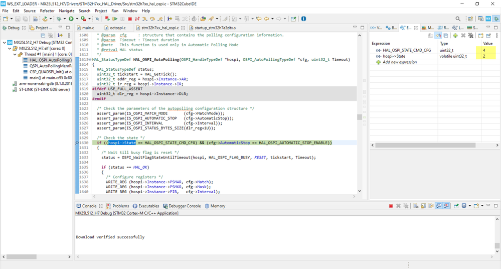

Thought, the debug fails here:
I wanted to check with you if my config was correct and if I missed something/mistaken somewhere.
