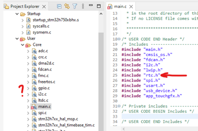

@iDeew wrote:the header file is not appearing in the Project Explorer of CubeIDE.
Header files don't need to be listed in the Project - they are found via the #include directives in the code.
More importantly, the rtc.c file is not appearing in your Project - it should be in that list you've marked with the question mark:
That'll be why it's not being built and, thus, why there's no definition for MX_RTC_Init
