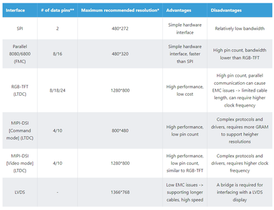

TouchGFX runs on any kind of display, and is not dependent on display technologies, interfaces, viewing angles, brightness etc but these are the display resolutions recommended for TouchGFX to achieve the intended performance: (according to this Link)
