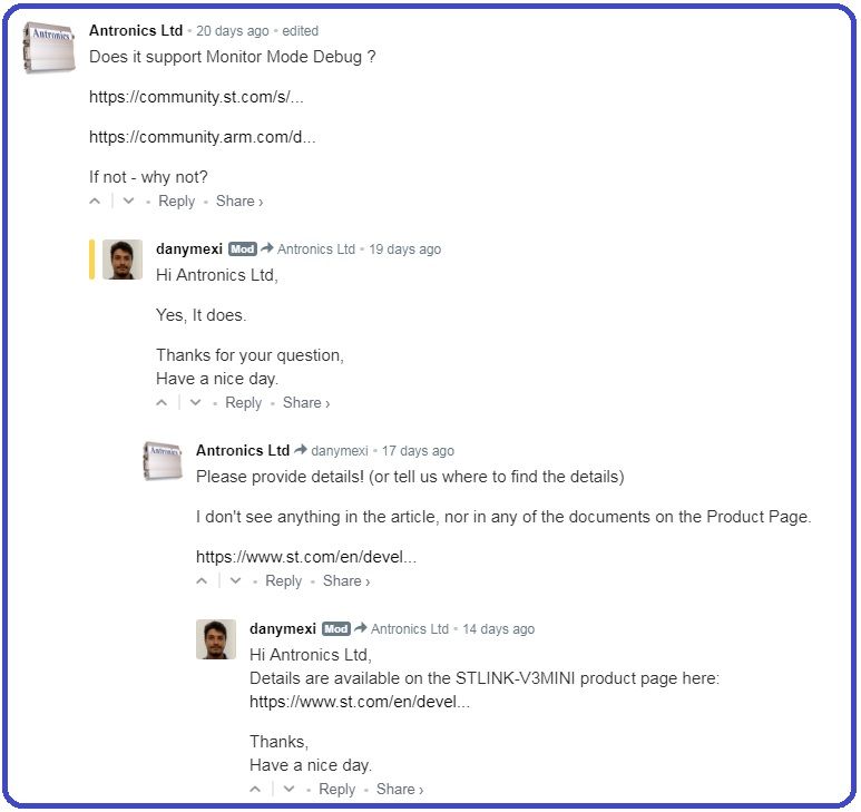

2019-07-26 3:32 AM
Allegedly, the ST-Link v3 does have it
:smiling_face_with_smiling_eyes:
though ST seem strangely reluctant to give any details
:unamused_face:
https://blog.st.com/stlink-v3set-in-circuit-debugger-programmer/#comment-4552578664

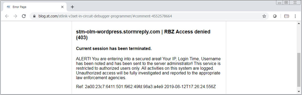

2019-08-12 10:28 AM
Still no reply from ST to confirm whether Monitor Mode Debug really is supported.
And the blog seems no longer available:
2019-08-12 10:58 AM

2019-08-12 11:11 AM
So has the blog blacklisted me for asking too many questions?
As far as I can see, danymexi's last reply there is not true; as I said in my preceding question, I cannot see any details anywhere in any of the documentation.
I had posted another question in reply, but it's just stuck in moderation.
Or been ignored?
I guess danymexi's not a (very) technical guy, and doesn't get the question ?
