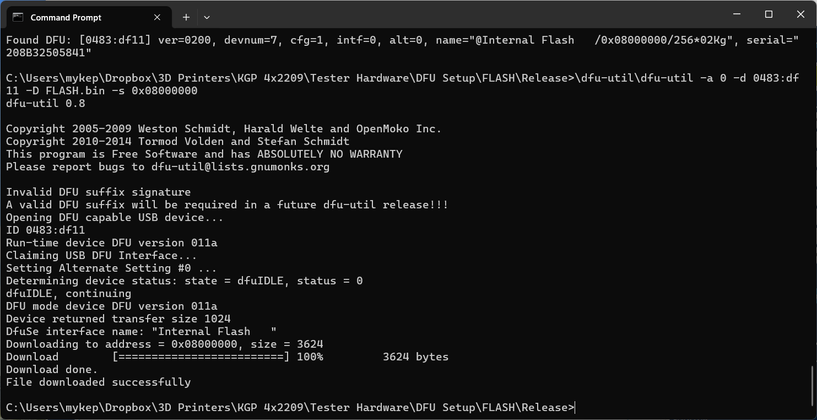

First I created a simple application to Flash an LED on the test board, I created a .bin version of it and loaded it using DFU:
As you can see in the screenshot above, the download takes place without issue.
The only problem I have is that the code won't start executing after I load it - I have tried adding the ":leave" modifier but no joy. If I reset the board, the code works fine with the LED flashing as expected.

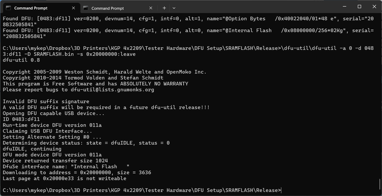

I created a new project with the same main.c as the first case but with the following changes:
MEMORY
RAM (xrw) : ORIGIN = 0x20002000, LENGTH = 144K
FLASH (rx) : ORIGIN = 0x20000000, LENGTH = 512K

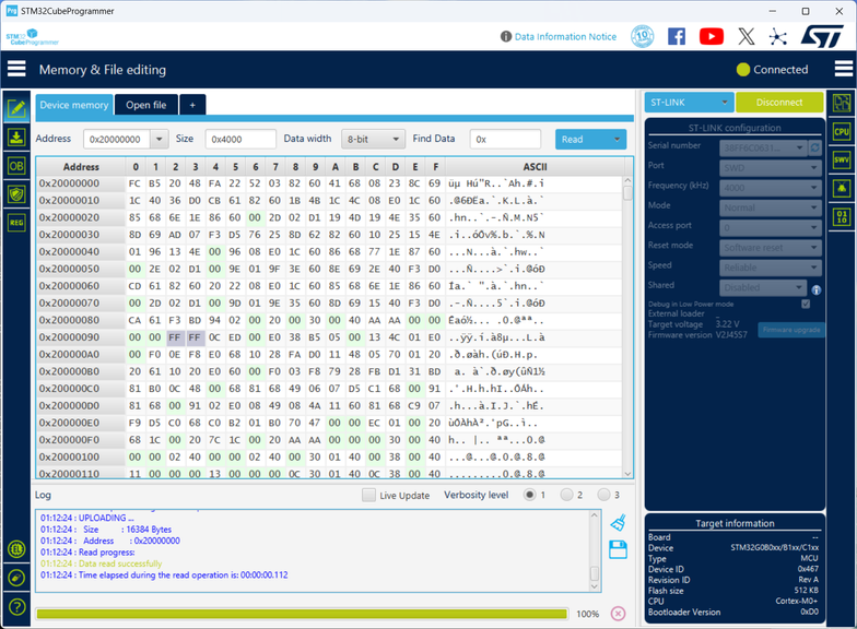

}I then attach S-Link, connect (without touching anything on the board including power or the USB cable) and look at the contents of SRAM and see:

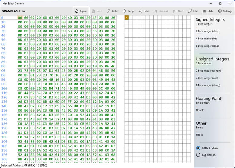

So, the immediate issues I see here are:
So, any ideas?
