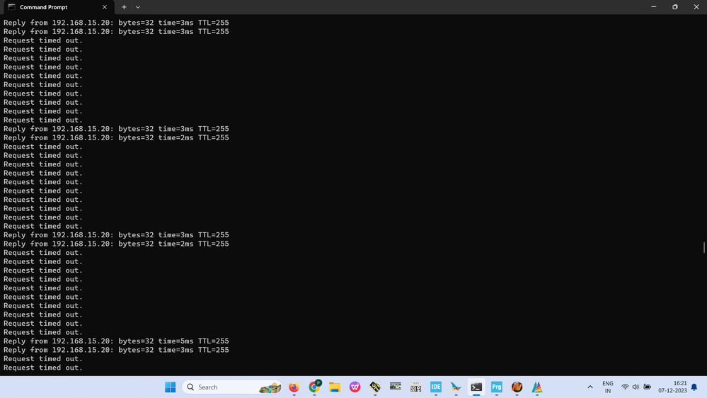

I'm using 2 STM32F4 MCUs for Modbus TCP Server/Client implementation based on LWIP. One MCU as a Client and other one as a Server. I have connect both MCUs through D-Link DES-1016D ethernet switch.
The problem is when I connect both MCUs directly (ie: without Ethernet switch) both Server-Client communicates properly. But if I connect them through switch, communication breaks from server side for some time and reconnects again.
If I ping the IP of Client it responds continuously. But when I ping the IP of Server, it responds for sometime and hit Request timeout for sometime.Server IP Ping test
Because some other TCP connections also are in my setup so I need to connect both the MCUs through switch only. Does anyone already succeed implementing such behavior?
