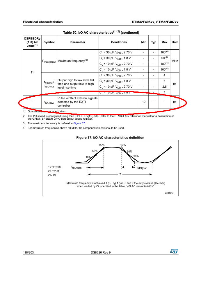

What should be the minimum pulse width of the signal which can be detected by the GPIO pin of the STM32 and on which factor this detection depends upon?
2022-09-14 4:05 AM
If you are talking about minimum pulse length detected by EXTI, it's given in the datasheet to your STM32, for example:
