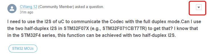

Please don't put the entire post in the Title - see:
https://community.st.com/s/article/How-to-Post
Limit the title to ~ 70 characters.
You can edit it - use this button:
#KeepTitleBrief
