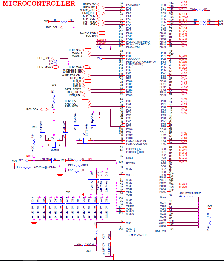

2017-05-16 12:15 AM
Hi Clive,
I have found out couple of differences between my custom board schematic and stm32f429zi disco. And PFA of my custom board schematic.

2017-05-16 11:24 AM
The DISCO however uses an 8 MHz crystal/clock-source, so different code and PLL settings WILL be required.
You should enable the HSE and feed it out via the MCO (PA8) pin and verify the clock from there. The PLL_M setting will need to changed from 8 to 25 to get the correct 1MHz comparison frequency into the PLL.
You've indicated you've done this, but the 'same code' argument falls over here unless you modify the DISCO board with your oscillator design, and disconnect the 8 MHz source. I would tend to do some very simple test code when bring up the board, and instrument that via a serial port to pin down where in the SystemInit() or PLL/Clocking code things were going awry.
