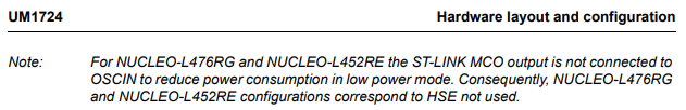

In addition to the unpowered ST-Link holding NRST low, as @Sarra.S mentioned, note that the MCU clock source on most* Nucleo boards defaults to the ST-Link - have you taken that into account?

* It seems that the Nucleo-L476RG is an exception:

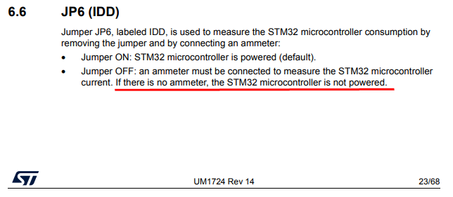

@SWenn.1 wrote:I have removed JP6
JP6 is the Idd measuring link - when you remove that, you disconnect power from the Target MCU.
The idea is that you insert a current meter here to measure the Target MCU's current consumption:
