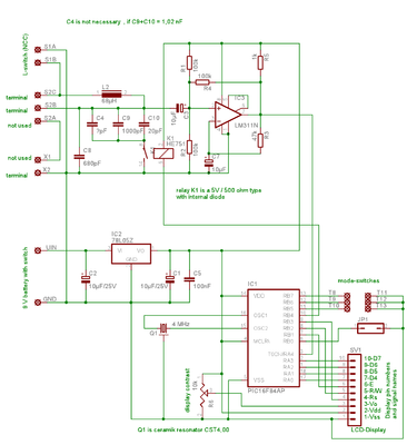

You can read about the principle here : (maybe translate...)
https://www.sprut.de/electronic/pic/projekte/lcmeter/lcmeter.htm
You can leave away the relais etc.  , you only want measure C , not L + C .

thank you, I'll look into it. Don't even have to translate :)
