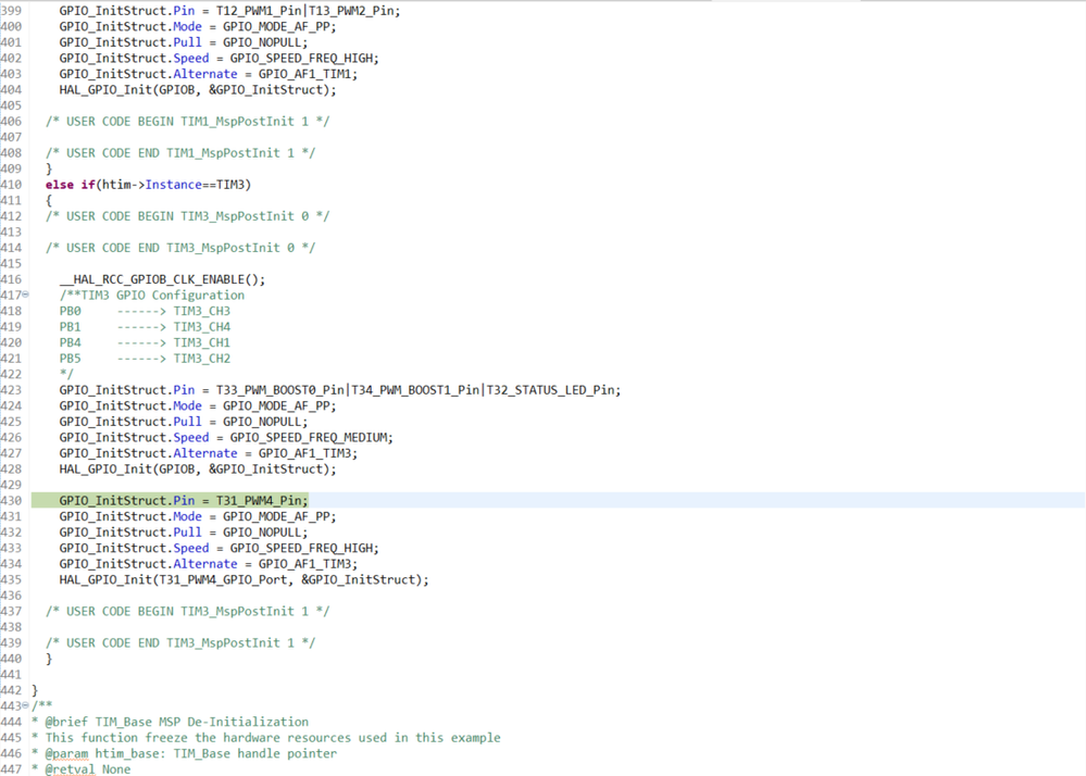

2024-04-23 5:51 AM
In line 423, are you sure that pin named STATUS_LED_PIN should be in mode AF1_TIM3?
