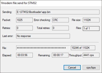

Updating the information, now I'm porting from STM324x9I_EVAL in STM32Cube_FW_F4_V1.18.0 release.
And using hyperterminal for sending the app.bin and now the transfer process is stack and aborted in 1024KB.
Debugging in, the transfer fail in matching process :

return(FLASHIF_WRITINGCTRL_ERROR); <-- It's return error for 1024KB transfer.

Review memory content at address before/after write to understand the failure. You get one attempt to write each word.
