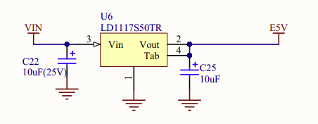

Both boards use SOT223 type 5 volt linear regulator(LD1117S50TR) as shown below:

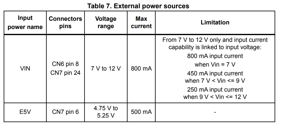

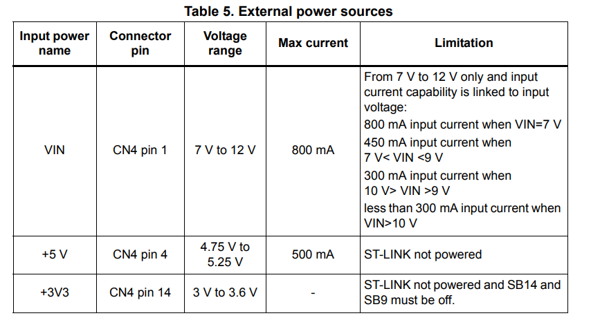

And the boards have the following tables for current limitation at several VIN:
And in my case the voltage drop will be (12.5)=7V and since the board will sink 100mA, it means the regulator of the board needs to dissipate 700mW. As I know SOT223 types cannot be heatsinked. And I'm wondering is it really fine to use this board up to 100mA at 12 VIN voltage.
Again to sum up, in my case my power supply is 12V 6A and the voltage regulator of the Nucleo board sinks 100mA in my case. The table says 250mA/300mA limit at 12V VIN; but I'm a bit confused how they dissipate such heat.
How can I know whether the regulator on this board can withstand the heating? Can I rely on the table? And at up to what ambient temperature this is valid for?

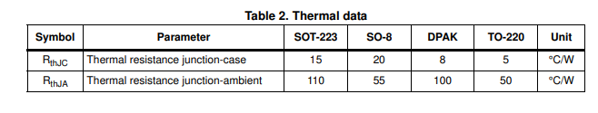

so loss will be about 0,7W , from 1117 data can see:
0,7 * 110 = 77° rise, with ambient at 30° you should get about 107° C at the 1117 chip.
-> it should survive for some time.

You can probably rely on the table. The original design probably was done to be compatiblr witg Arduino Uno connector and functionality. Checkout their forum for xtra info. Otherwise a dcdc voltage regulator board piece will do a better job at higher current than linear cheaper linear regulator.
