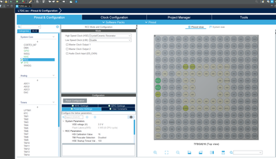

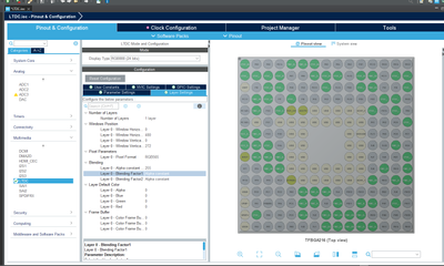

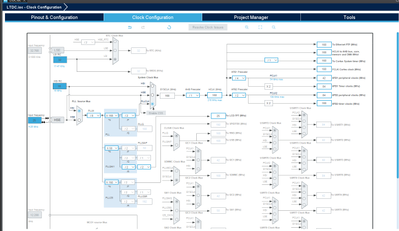

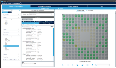

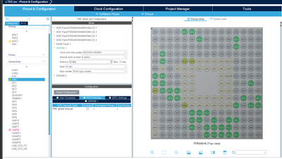

Hello @SofLit,
Thank you so much for your quick response and for sharing the article! I truly appreciate your help and the time you’ve taken to guide me.
I’ve already reviewed the article you mentioned, and while it’s a great resource, it uses TouchGFX, which isn’t what I’m looking for right now. My goal is to manually configure the LTDC initialization directly in STM32CubeMX without using TouchGFX.
To clarify further, I’ve attached screenshots of my current STM32CubeMX configuration for the LTDC and related settings. I’d really appreciate it if you could review them and let me know if there’s anything I might have missed or need to adjust.
I saved the project and my code was generated
Thank you once again for your patience and support as I navigate through this process!
Best regards!
