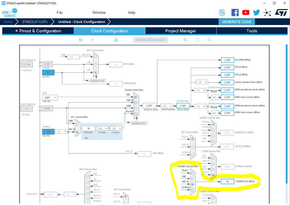

You need to check your clock configuration.

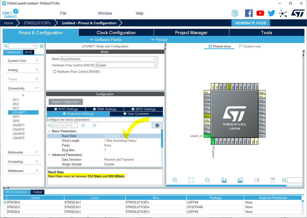

1- With this conf :
=> Baud Rate must be between 512 Bits/s and 699 KBits/s. So you can set Baud Rate with 1200bits/s.

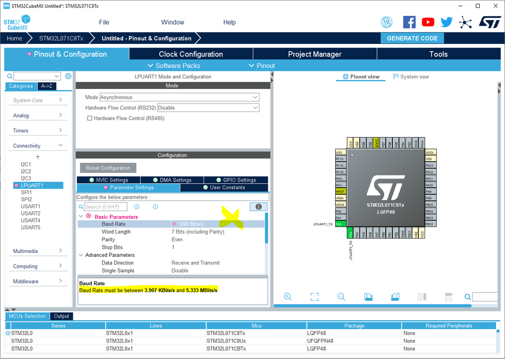

2- With this conf :
=> Baud Rate must be between 3.907 KBits/s and 5.333 MBits/s. So you can not set Baud Rate with 1200bits/s.
