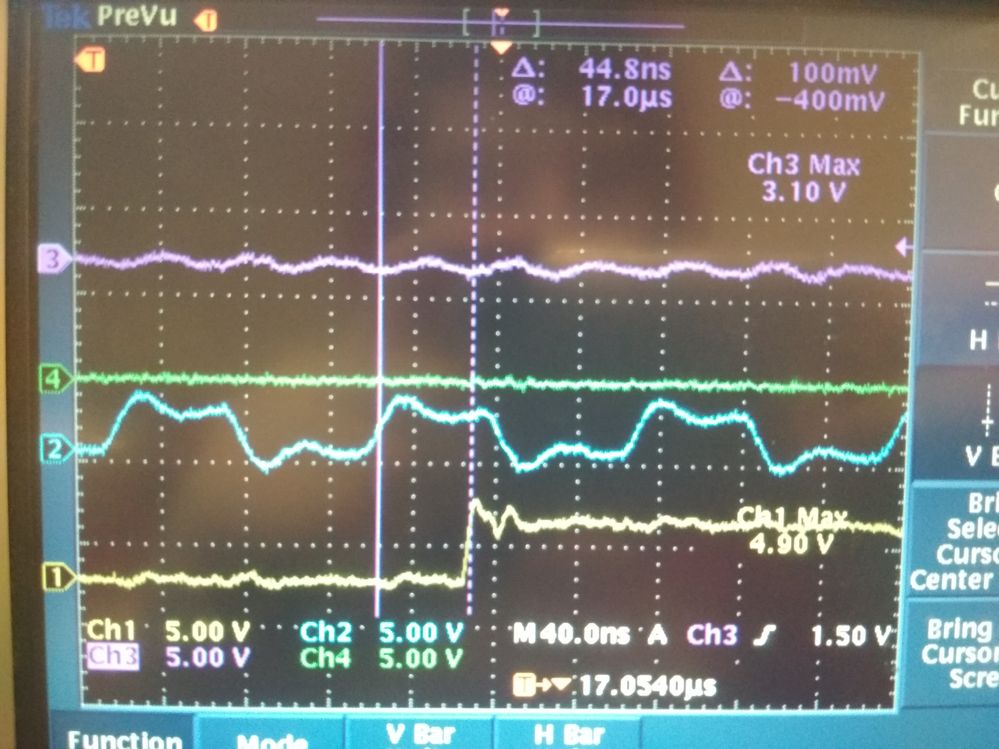

The latency is between the external clock that is going into ETR2 of Timer 8(which produces the 6 pulses) and 4(which triggers timer 8) on the stm32f722ze and its output when it reaches overflow. At merely 8 MHZ, it provides a latency of nearly half a clock cycle to transition.Shown below is a external clock frequency of 8MHz, at overflow it takes 44 nanoseconds to transition to a high state on timer8. This is with fast mode enabled and pins set to very high frequency

I am not very familiar with exact timing between ETR and the clock advancement; and between the compare event and output; and AFAIK this is not documented well if at all. There is certainly at least one synchronizer (i.e. delay between one to two timer clock, depending on the particular phase between external signal's edge and timer clock's edge) at the ETR input, and I suspect there may be at least one more between the compare unit and the output. Start with a simple few-clock PWM driven from the external clock, and measure the latency, varying the timer clock (i.e. related APB clock, through the APB divider, or for that matter changing the system clock, whatever you find easier).
You may be better off deliberately delaying the whole pulse train by a whole external clock cycle, by setting a filter on ETR. That again is driven from the respective APB clock.
IMO DMA won't help you here: the input signal is again through timer i.e. at least the input portion of delay is still there; and the arbitration within the DMA and on the buses involves not only delay but also jitter (i.e. that delay is varying, depending on what does the rest of the system do).

So I should generate a PWM signal and measure the latency between it and the external clock to double check?
Yes. And assess the impact of timer clock=APB frequency on it.
I'd also say, that ETR is sampled by the DTS clock, so changing TIMx_CR1.CKD will probably also have some impact.
