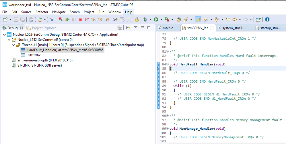

I then run debug but it keeps failing on
I don't see where I can change or check for the IT priority of the UART. I would appreciate if you show me.

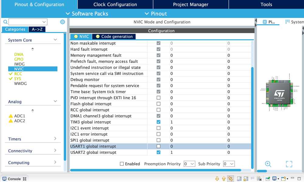

You can also set priority level during project configuration within cubeMX, under System/NVIC settings window. See thee attached screen shot. As you can see I set Time3 and UART2 interrupts a lower level compared to sysTick.
Hope this will help.
