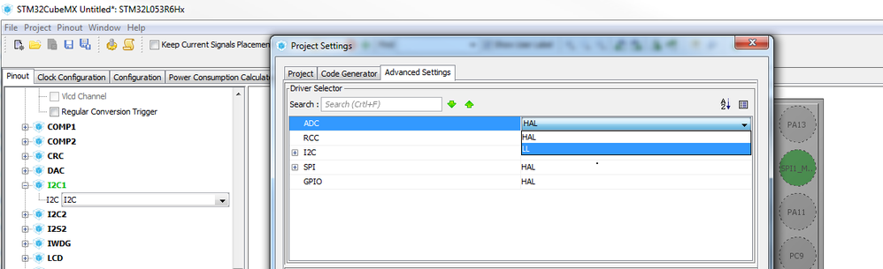

I was looking to import LL driver for my STM32L053 device. I see user manual for STM32F4 LL driver. I wanted to know if
we have LL code generation support in STM32CubeMX for STML0xx family?

,Please note STM32CubeMX support generating code based on LL drivers for L0 series.
If you need to generate initialization code based on LL driver, you have just u
se the ''Advanced Settings'' tab from the Project Settings window, to select ''LL'' instead of default HAL drivers for code generation.Kind Regards

Thank you so much Imen. I had looked in the advanced settings, but the drop down arrow appears only when I click on the peripherals. I missed it completely. Thank you for the response. I appreciate it.
