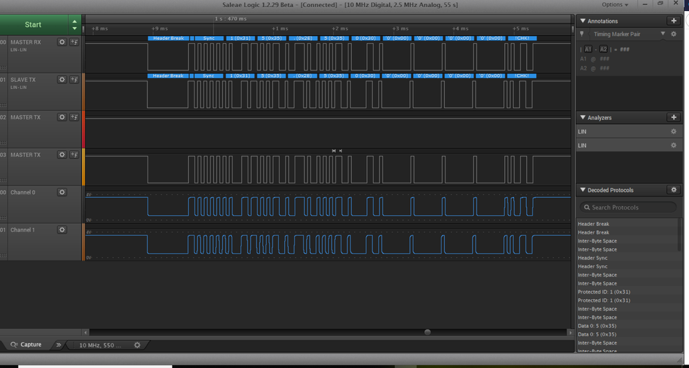

2018-11-25 10:33 AM
hi i can obtain message for NVIC interrupt using protocol UART/USART i am using stm32f3 (slave), stm32f7 (master) node
transceiver is mcp2021
