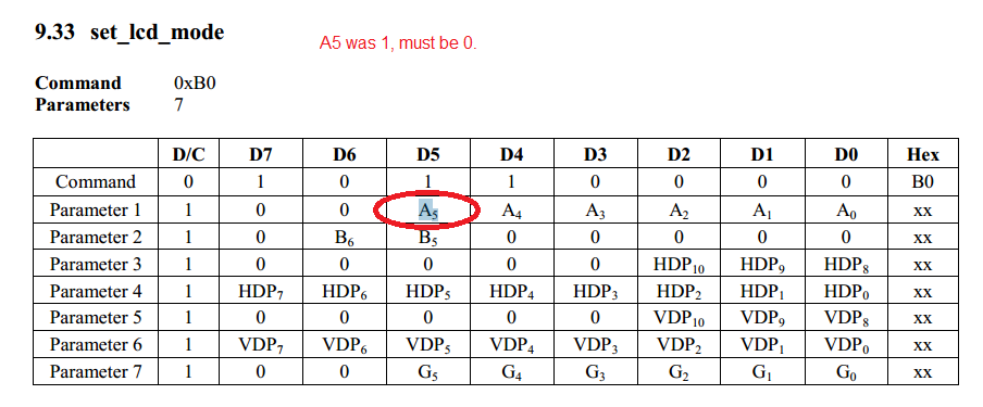

I found some information about the driver board: connection between ssd1963 and lcd panel is 18 bits width, the first parameter of set_lcd_mode (0xb0) was set as 0x0020, which refers to a 24 bit connection, I changed it to 0x0000 (actually I need to set bit A5 of the first parameter to 0, instead of 1).2014-07-23 12:29 PM

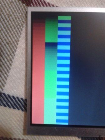

As a last try for tonight, I upload a photo that shows three bars, each supposed to be a gradient from 00 to FF of R and G and B.
2014-07-23 2:34 PM
What examples does the panel vendor provide?
