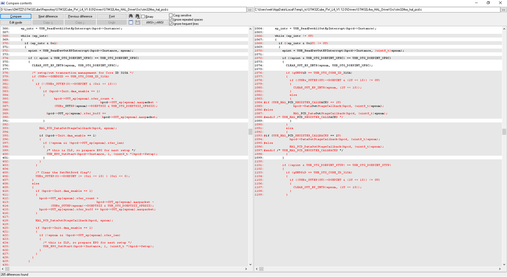

Setting the mysterious bit 15 in DOEPINT persist in the newest 1.12 version of Cube, together with using the undocumented CoreID:
0690X0000060CEYQA2.pngAlso, reading out the CoreID has been somewhat obfuscated in the new version, instead of using the USB registers typedef:
 uint32_t USBx_BASE = (uint32_t)USBx;
 uint32_t TempReg = USBx_BASE + 0x40U;
 uint32_t gSNPSiD = *(uint32_t *) TempReg;
One would expect that this is because of the undocumented registers (not only the CoreID, but also the HWConfig registers) disappeared from the CMSIS-mandated device header, but it's not the case...
