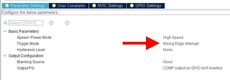

So far I have determined that bad things start to happen with interrupt enabled, irrelevant if they are really used:
Rising edge event does not cause this problem.
I presume something went wrong in CubeMX code generation with EXTI lines.....will continue my research....
