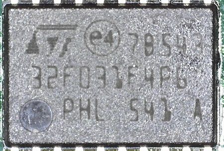

Is it possible it is date code dependent? (IC picture attached)
