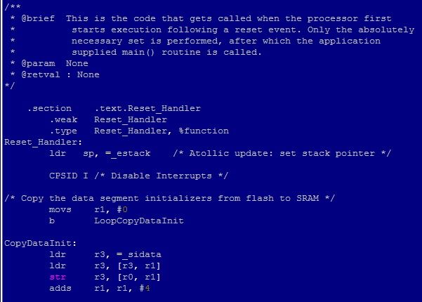

I am using Atolic TrueStudio and have some global variables. For some reason one variable is simply updating every time I step through the code with the debugger. I am using a STM32L433 processor and have 56k ram free. The variable is a character and located at 0x20001165 . As soon as the the debugger runs it goes into the below code within startup_stml433xx.s . I have the variable in the expressions so I can see its value, and also looked at the memory location. Every time I step through the below (and any part of the program) the variable just increases by 1. I know no other part of the application is being called. I tried increasing the stack, heap just in case. Also, moved the variable to a different memory location, and even changed its name, but still it increases. Anyone any ideas?

Is this the primary/only code in the system?
Or is there a loader or some other code that is run first, before this application?
Add "CPSID I" instruction as first thing it does in Reset_Handler

Yes, its the only code in the system, no loader is ran. I have never done assember on the STM32, only 68000 processors. Where would I add this line, and what exactly does this do?

startup.sThe only thing I'd expect to cause a memory location increment is a SysTick driven HAL_IncTick()

Many thanks, that fixed one of the weirdest things I have saw in programming :)
