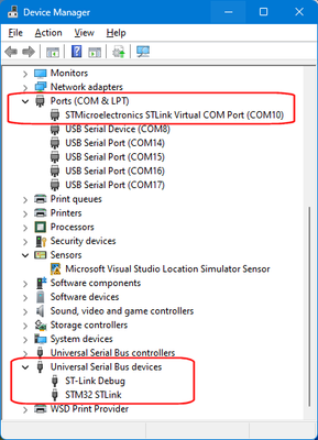

2024-03-20 11:58 AM - edited 2024-04-24 1:03 AM
Does it appear in your Device Manager:
Have you tried different physical USB ports?
Are you using a Hub? If so, what happens if you go straight to the computer instead?
Are you sure the cable is good? Have you tried different USB cables?
#VCPDeviceManager

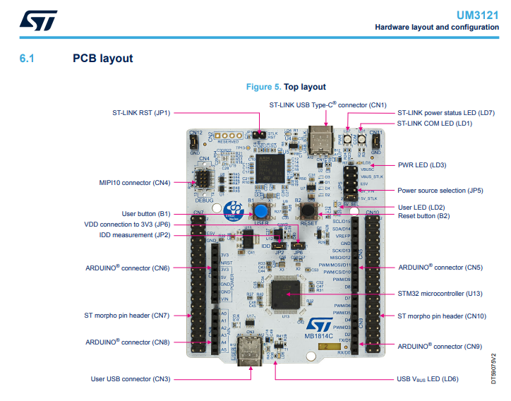

2024-03-20 11:14 AM
@LukeJang522 wrote:I thought ST-Link was on board
Yes, it is:
Note that there are two USB connectors - are you sure you're using the correct one?
2024-03-20 11:19 AM
Hi andrew Neil,
Thank you for your reply.
Yes, I've connected the cable to USB STLK which is on the TOP. also I can see the lights from the LD7, LD1, LD2, LD3.
#VCPDeviceManager
