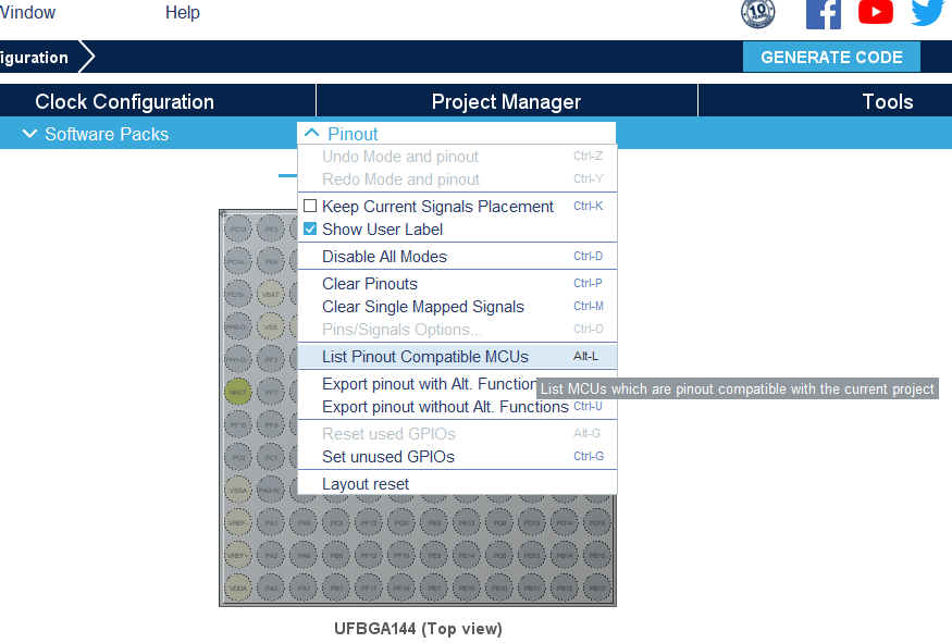

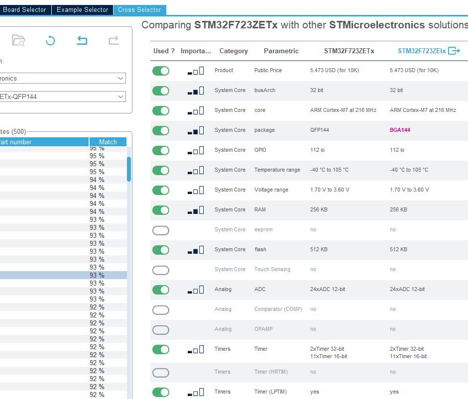

You can use the STM32CubeMX tool, which offers the features to compare the characteristics of two or more MCUs through the "Cross Selector" tab, and to display the list of compatible MCUs, then export your current project configuration to a compatible MCU.
I advise you to refer to the UM1718 in section "Cross selector" and "Tutorial 5: Exporting current project configuration to a compatible MCU"

Imen.D
I have attached the Excel file containing a comparison of the characteristics and features between these devices.
