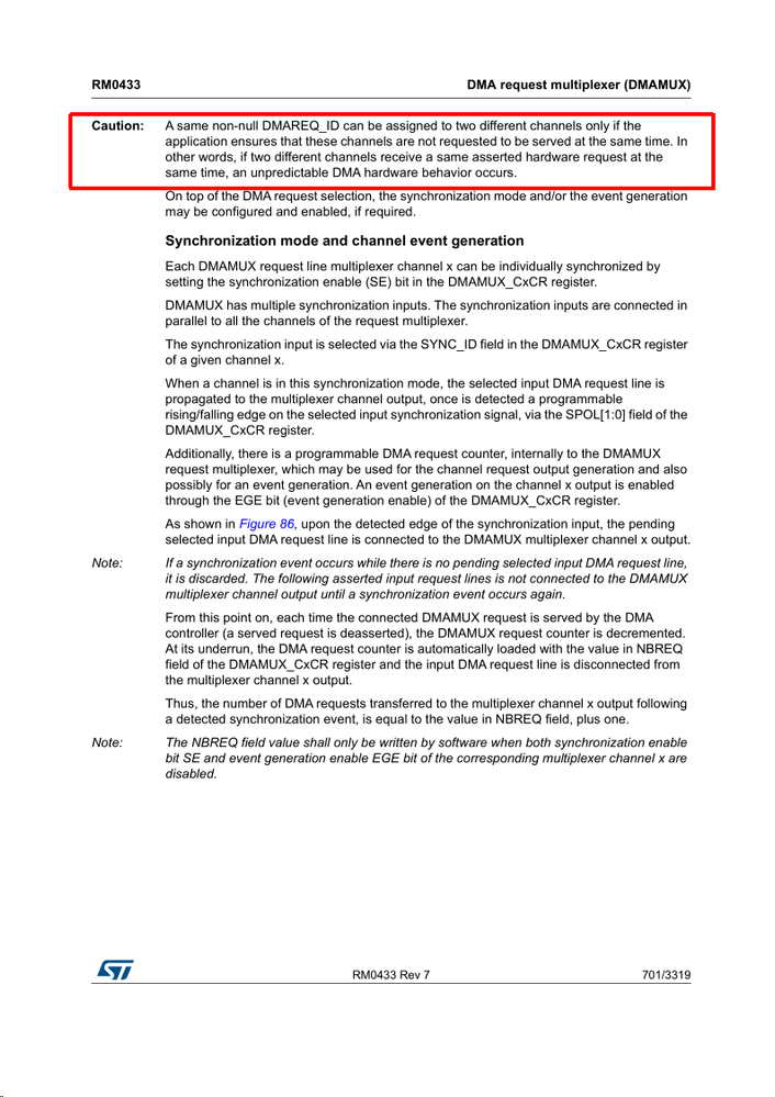

No.
The underlying reason is, that for some peripherals - including TIM - the DMA request goes through a latch, which is reset by the DMA/DMAMUX when the request is served. In other words, the first channel which serves the given request clears the latch, with unpredictable results to the second channel connected to the same request. In 'F4, this leads to one of the DMA streams to be frozen entirely (guess how do I know :) ); with DMAMUX the results may be different, but the above warning in the RM indicates, that this is simply something which is not to be attempted.

2023-05-22 5:58 AM
That just means, that you can use any DMAMUX channel for any request, not that you can use several DMAMUX channels at the same time for the same request. See the RM screenshot I gave above.

2023-05-23 6:13 AM
I see your point, and yes, it could be constructed in this way, but the why would be the warning about not to use one trigger simulteneously by several DMAMUX channels.
Yes, I would love to hear somebody who actually knows the STM32 internals to chime in, but that won't happen.
