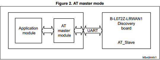

My purpose is to realise a new set up for LoRa.
Before, I used a B-L072Z-LRWAN1 board with the I-CUBE-LRWAN1 software with the End Node code or the AT SLAVE code.
For the AT_SLAVE code, I used a terminal to send AT COMMAND to the MCU of my LoRa module.
Now, I want to configure my B-L072Z board with the AT_SLAVE code (as I realized before) but send AT_COMMAND with a Nucleo_L073RZ board with the AT_MASTER code (and not with a terminal). In comparison with this picture, I don't have application module and my AT_master module will be a the Nucleo_L073RZ board.
Is it possible? Is the AT_MASTER code functionnal with a Murata LoRa module?
Should I just connect Tx-> Rx and Rx_>Tx and GND of the two board to communicate (UART) or there is some modification with jumper?
Thanks in advance!
Max
2017-05-26 5:24 AM
>>Is it possible?
Yes, but is complicated on the NUCLEO and DISCO boards as the USART are connected to the ST-LINK/VCP. You will need to review the schematics to determine the connectivity and solder-bridges, and disconnect the USARTx_RX pin from being driven by the ST-LINK.
The DISCO is designed for you to implement the entire LoRa app, and thus avoid the need to go via the AT command protocol.

2017-05-29 9:16 AM
I don't believe it is too complicated, but does require an appreciation about the connectivity, and software/pins. I would expect I2C and SPI to be viable paths, but require more code ownership and change.
The original AT command firmware is expecting to use the USART via PA2/PA3 (LPUSART1), using a different USART on PA9/PA10 (USART1) will require adjustments in the code.
