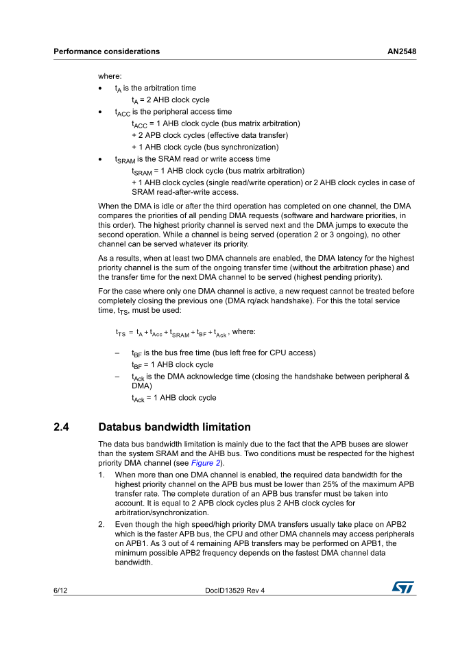

More like 6 AHB + 2 APB cycles, if there's no collision with other masters on the buses and no other DMA channel active - this might be a showstopper.
I know AN2548 is for 'F1 and 'L1, but the DMA in 'F3 appears to be of the same design.
I'd recommend you to write a simple test application, perhaps on a Disco or Nucleo, before commencing with design. Using external modulator as Clive suggested above is always a sure bet of course.
