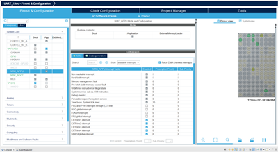

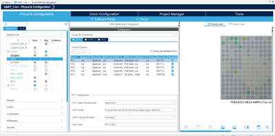

Here I attached some snapshot of configuration and code i have write.

Did you set break points in EXTI IRQ handlers? are they reached?
2024-12-13 6:33 AM
Thanks for answering.
No it is not reached to the EXTI IRQ handlers.
/Mehul
2024-12-13 7:38 AM
I'm not seeing an issue with what you shared (except I'm missing something)!
Is that possible to zip your project and share it here?

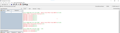

2024-12-15 8:36 PM - edited 2024-12-15 8:37 PM
After loading the program, an interrupt is generated without pressing the USER button (PC13) at starting. However, after pressing the button, no interrupt is generated. It is only detected by for loop "Button 4 is pressed".
here is my code,

UART_Print("Hello from STM32 from UART4!\n\r");
printf("Hello_STM32 from printf function!\n\r");
/* USER CODE END 2 */
/* Infinite loop */
/* USER CODE BEGIN WHILE */
while (1)
/* USER CODE END WHILE */
/* USER CODE BEGIN 3 */
buttonState[0] = HAL_GPIO_ReadPin(GPIOF, BUTTON_1_Pin);
buttonState[1] = HAL_GPIO_ReadPin(GPIOF, BUTTON_2_Pin);
buttonState[2] = HAL_GPIO_ReadPin(GPIOF, BUTTON_3_Pin);
buttonState[3] = HAL_GPIO_ReadPin(GPIOF, BUTTON_4_Pin);
buttonState[4] = HAL_GPIO_ReadPin(GPIOC, BUTTON_5_Pin);
// UART_Print("Hello from STM32!\n\r");
// printf("Hello_STM32!\n\r");
// HAL_Delay(5000);
for (int i = 0; i < 5; i++)
if (buttonState[i] == GPIO_PIN_SET) // If the button is pressed
printf("Buttton %d is pressed\n\r",i);
HAL_GPIO_TogglePin(GREEN_LED_GPIO_Port, GREEN_LED_Pin);
HAL_Delay(100);
/* USER CODE END 3 */
* @brief FLASH Initialization Function
* None
* @retval None
static void MX_FLASH_Init(void)
/* USER CODE BEGIN FLASH_Init 0 */
/* USER CODE END FLASH_Init 0 */
/* USER CODE BEGIN FLASH_Init 1 */
/* USER CODE END FLASH_Init 1 */
/* USER CODE BEGIN FLASH_Init 2 */
/* USER CODE END FLASH_Init 2 */
PUTCHAR_PROTOTYPE
/* Place your implementation of fputc here */
/* e.g. write a character to the LPUART1 and Loop until the end of transmission */
HAL_UART_Transmit(&huart4, (uint8_t *)&ch, 1, 0xFFFF);
return ch;
* @brief UART4 Initialization Function
* None
* @retval None
static void MX_UART4_Init(void)
/* USER CODE BEGIN UART4_Init 0 */
/* USER CODE END UART4_Init 0 */
/* USER CODE BEGIN UART4_Init 1 */
/* USER CODE END UART4_Init 1 */
huart4.Instance = UART4;
huart4.Init.BaudRate = 115200;
huart4.Init.WordLength = UART_WORDLENGTH_8B;
huart4.Init.StopBits = UART_STOPBITS_1;
huart4.Init.Parity = UART_PARITY_NONE;
huart4.Init.Mode = UART_MODE_TX_RX;
huart4.Init.HwFlowCtl = UART_HWCONTROL_NONE;
huart4.Init.OverSampling = UART_OVERSAMPLING_16;
huart4.Init.OneBitSampling = UART_ONE_BIT_SAMPLE_DISABLE;
huart4.Init.ClockPrescaler = UART_PRESCALER_DIV1;
huart4.AdvancedInit.AdvFeatureInit = UART_ADVFEATURE_NO_INIT;
if (HAL_UART_Init(&huart4) != HAL_OK)
Error_Handler();
if (HAL_UARTEx_SetTxFifoThreshold(&huart4, UART_TXFIFO_THRESHOLD_1_8) != HAL_OK)
Error_Handler();
if (HAL_UARTEx_SetRxFifoThreshold(&huart4, UART_RXFIFO_THRESHOLD_1_8) != HAL_OK)
Error_Handler();
if (HAL_UARTEx_DisableFifoMode(&huart4) != HAL_OK)
Error_Handler();
/* USER CODE BEGIN UART4_Init 2 */
/* USER CODE END UART4_Init 2 */
* None
* @retval None
/* GPIO Ports Clock Enable */
__HAL_RCC_GPIOF_CLK_ENABLE();
__HAL_RCC_GPIOB_CLK_ENABLE();
__HAL_RCC_GPIOD_CLK_ENABLE();
__HAL_RCC_GPIOC_CLK_ENABLE();
__HAL_RCC_GPIOO_CLK_ENABLE();
/*Configure GPIO pin Output Level */
HAL_GPIO_WritePin(GREEN_LED_GPIO_Port, GREEN_LED_Pin, GPIO_PIN_RESET);
/*Configure GPIO pins : BUTTON_3_Pin BUTTON_2_Pin BUTTON_4_Pin BUTTON_1_Pin */
GPIO_InitStruct.Pin = BUTTON_3_Pin|BUTTON_2_Pin|BUTTON_4_Pin|BUTTON_1_Pin;
GPIO_InitStruct.Mode = GPIO_MODE_IT_RISING;
GPIO_InitStruct.Pull = GPIO_PULLDOWN;
HAL_GPIO_Init(GPIOF, &GPIO_InitStruct);
/*Configure GPIO pin : BUTTON_5_Pin */
GPIO_InitStruct.Pin = BUTTON_5_Pin;
HAL_GPIO_Init(BUTTON_5_GPIO_Port, &GPIO_InitStruct);
/*Configure GPIO pin : GREEN_LED_Pin */
GPIO_InitStruct.Pin = GREEN_LED_Pin;
GPIO_InitStruct.Speed = GPIO_SPEED_FREQ_HIGH;
HAL_GPIO_Init(GREEN_LED_GPIO_Port, &GPIO_InitStruct);
/* EXTI interrupt init*/
HAL_NVIC_SetPriority(BUTTON_1_EXTI_IRQn, 0, 0);
HAL_NVIC_EnableIRQ(BUTTON_1_EXTI_IRQn);
HAL_NVIC_SetPriority(BUTTON_2_EXTI_IRQn, 0, 0);
HAL_NVIC_EnableIRQ(BUTTON_2_EXTI_IRQn);
HAL_NVIC_SetPriority(BUTTON_3_EXTI_IRQn, 0, 0);
HAL_NVIC_EnableIRQ(BUTTON_3_EXTI_IRQn);
HAL_NVIC_SetPriority(BUTTON_4_EXTI_IRQn, 0, 0);
HAL_NVIC_EnableIRQ(BUTTON_4_EXTI_IRQn);
HAL_NVIC_SetPriority(BUTTON_5_EXTI_IRQn, 0, 0);
HAL_NVIC_EnableIRQ(BUTTON_5_EXTI_IRQn);
/* USER CODE BEGIN MX_GPIO_Init_2 */
/* USER CODE END MX_GPIO_Init_2 */
/* USER CODE BEGIN 4 */
/* USER CODE END 4 */
* @retval None
void Error_Handler(void)
__disable_irq();
while (1)
#ifdef USE_FULL_ASSERT
* file: pointer to the source file name
* line: assert_param error line source number
* @retval None
/* USER CODE BEGIN 6 */
ex: printf("Wrong parameters value: file %s on line %d\r\n", file, line) */
/* USER CODE END 6 */
#endif /* USE_FULL_ASSERT */
~Mehul
