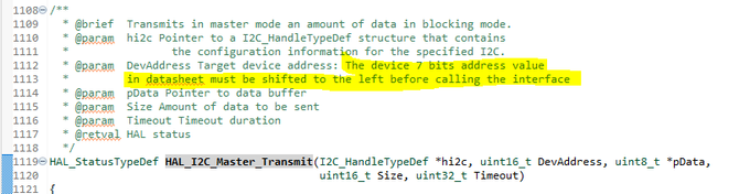

uint16_t Device_Add = 36 << 1;

Thanks Karl,
Master is sending the data to slave, slave received the data in while(1).
