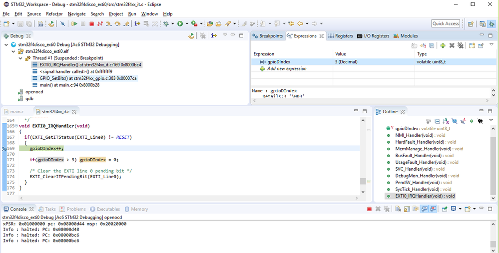

2017-10-30 9:20 AM
Your code run correctly for me (see capture below)
Breakpoint is reach when PA0 [USER_BLUE_BUTTON] is pressed and PORTD LED onbard are set.
I can share with you SW4STM32 project. But I'm use Windows OS.
To see if interrupt occurs, you must place a breakpoint into EXTI0_IRQHandler() and run the debugger.

reicher.romain
, I notice you put the EXTI0_IRQHandler inside the file stm32f4xx_it.c while I don't, because I don't have this file included in my project. I only have its header file stm32f4xx_it.h included (automatically).Where is the stm32f4xx_it.c file ?
The interrupt in my code is never executed.
