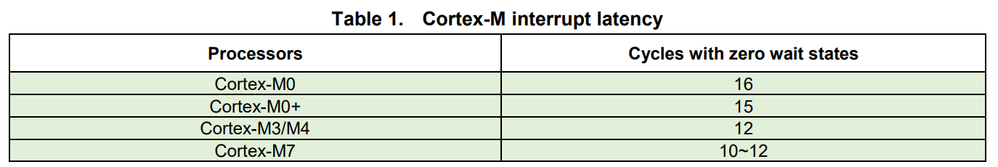

HAL_GPIO_EXTI_Callback is not the direct callback function. The callback is EXTIx_IRQHandler, which calls HAL_EXTI_IRQHandler, which calls HAL_GPIO_EXTI_Callback. 1.5us to get through that code, plus about 12 ticks for the IRQ itself to fire seems about right.

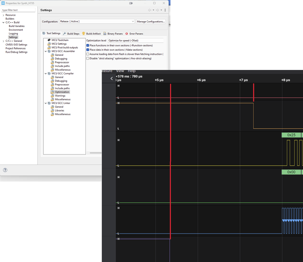

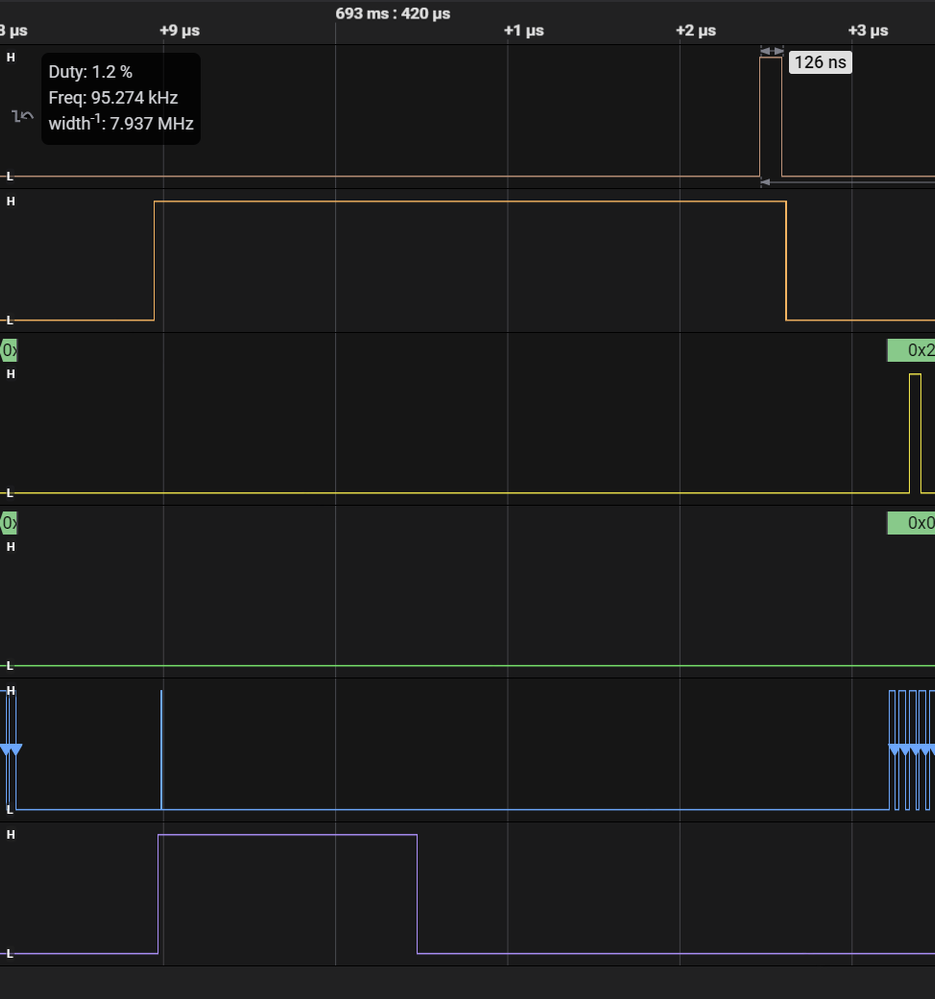

its saved me a whopping 126 ns

ok unlesss 1us is not enough time for the st to re arm the irq I think I the issue is code related. it seem to fire correctly the first time.
2022-12-07 8:07 AM
For 12 and 180MHz for example 66,6ns plus interrupt init instruction cycles...
