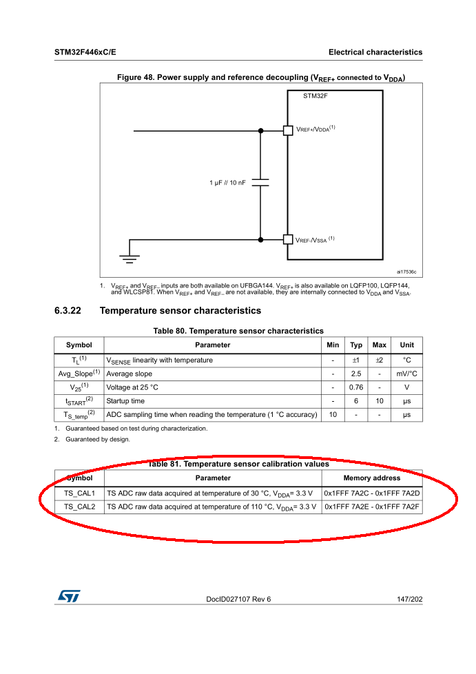

Some STM32 series have a factory calibrated temperature correction value stored in ROM, the STM32F4 lacks this feature. See the answer from @Community member below
2020-02-05 3:00 AM

Thanks for the infos, btw I'm looking for an accuracy of ±5°C so not very accurate :)
I'm using the macro __LL_ADC_CALC_TEMPERATURE to convert ADC to °C and this macro use the factory calibrated temperature correction value .
And with this I get a correct guess of the ambient temperature on the nucleo but not on my board
