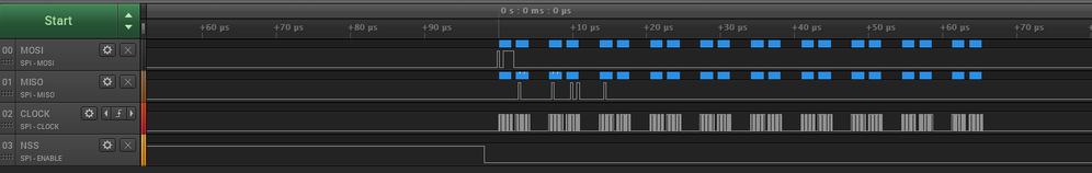

I also the SPI communication with a logic analyzer and the serial number bytes are exchanged on the SPI ad you can see in the below image:
Any suggestion?
I checked everything... But maybe I forget something.
Thanks!
