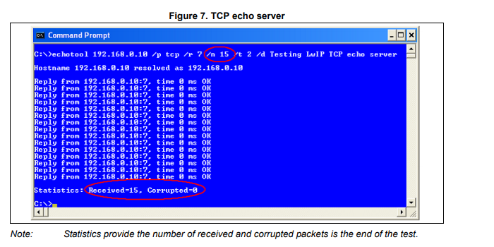

I am using STM32F4 EVALUATION Board. I want to implement an echo server based on netconn. I did the configuration of ethenret and tcp/ip and lwip. When I ping it works correctly but when type ' C:\>echotool IP_address /p tcp /r 7 /n 15 /t 2 /d Testing LwIP TCP echo server' in the command prompt it shows me this error ' reponse time out ' I did not understand why it is not working ???
when I debug the programm I noticed that the OS by osKernelStart does not call the function of tcpecho_thread that contains the foncions of receiving and sending datas. But it calls all the other thread.. I did not understand why It does not call the thread of tcp echo server.

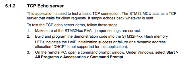

Hey echo server on STM32 is there on this manual.
Please once check this  UM1713
DM00103685.pdf file name.
http://www.st.com/content/ccc/resource/technical/document/user_manual/65/e8/20/db/16/36/45/f7/DM00103685.pdf/files/DM00103685.pdf/jcr:content/translations/en.DM00103685.pdf

Posted on May 03, 2018 at 12:17
Yes I have this document and I am following it already and I did all what is supposed to be done but I do not know why I can not connect to the echo server. I does not recognize the IP dress when I ping it in the command prompt. I have two months now blocked in this situation and I do not what to do
Thank you for your help
