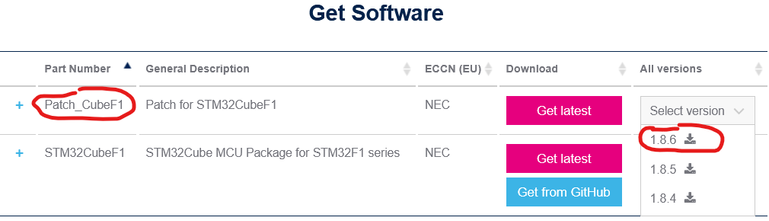

Hello, I am using firmware STM32CubeF1 v.1.8.6, the STM32Cube MCU Package for the STM32F1 series. The folder name in the Repository is STM32Cube_FW_F1_V1.8.6 (version 1.8.6).
In order to stay current I downloaded the latest the patch for STM32CubeF1, which is v.1.8.6, see the screenshot below. To my surprise the downloaded zip file 'stm32cubef1-v1-8-6.zip' contains the initial version STM32Cube_FW_F1_V1.8.0.
Question: is v1.8.0 the correct patch version for STM32CubeF1 v.1.8.6? It seems 'down rev'.
Thank you for your response!

Hello @Kmax18
It is normal, this is the way STM32Cube firmware patches are managed. Patch releases for STM32Cube firmware do not modify the package name: 'stm32cubef1-v1-8-6.zip' file retains the initial version STM32Cube_FW_F1_V1.8.0, even though it includes the patch update.
So, unzip the patch zip into a temporary directory, then copy the patch subtree over the initial full package release, this will overwrite the existing files. You can check that the Release_Notes.html, package.xml and all files are updated to reflect the patch 1.8.6 version, but the package name remains unchanged.
