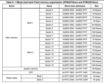

I am reaching out regarding a query about the STM32F407G-DISC1 target. Upon reviewing the datasheet, I noted that it indicates the target does not support reading while writing. However, upon personal experimentation, I found that it functions correctly in this regard.
Could you kindly provide clarification on this matter? I am curious to understand why my observations differ from the information provided in the datasheet.

STM32F407 does not support dual bank feature while for example STM32F42xxx and STM32F43xxx do.

I am currently working on implementing a full Firmware Over-The-Air (FOTA) project on the STM32F407G-DISC1 target. As part of this project, I am considering dividing the flash memory into two banks.
My primary query pertains to whether the STM32F407G-DISC1 supports executing code from bank1 while writing to another bank2
