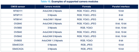

AN5020 application note mentioned some CMOS sensors examples that are compatible with the STM32 DCMI.
