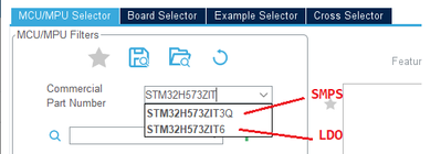

In Cube Mx type STM32H573ZI
You will get two part numbers one with Q and one without:
So you need: STM32H573ZIT6 as LDO flavor.
