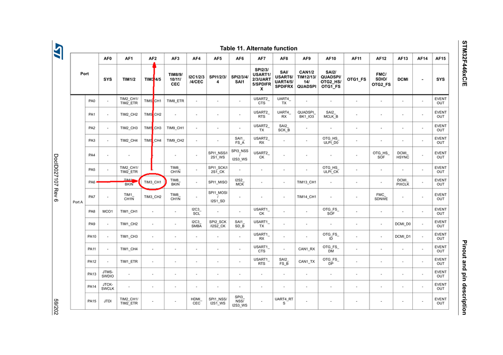

Read back the registers, all of them. Do they contain what you expect?
There should be a few cycles delay after enabling peripheral clocks in RCC (see Delay after an RCC peripheral clock enabling in the errata). I'd just change the order of initialization

Check PA6 - TIM3 mapping in the Alternate function table of the datasheet.

2020-04-28 11:56 PM
> GPIOA ->AFR[0] |= 1 << 24; //PA6 is Alternate function 1: 0001
Exactly as berendi said above:
